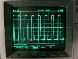

  • Hi Jeff—thank you for the rapid feedback. I can't get hold of a current probe quickly, but I measured the following waveform at SW1:
    It holds steady at 1.5 MHz, and doesn't seem to be entering DCM. SW2 holds steady at VREG. The BQ25798 registers at the time of the measurement appear as follows, with IBAT = 444 mA < ITERM = 480 mA:

  • Hi Jeff,
    I am bit puzzled as I haven't had any complaints about termination current set this high.  I have had complaints with termination current set down below 120mA.  I will schedule some bench time to look at this.  Can you remind me if you placed the 0.1uF SYS to GND capacitor as recommended in the datasheet?  The current sense amp that measures charge current is very noise sensitive.  To that end, I am curious what the charger's ADC reports for charge current?  Is it accurate?  The ADC uses the same current sense amp as the ICHG loop and termination comparator.  Another option might be to lower the charge current register setting below 1A once the current has tapered below 1A.  ICHG set < 1A makes the battery FET more resistive and therefore gives a more accurate current measurement.  This has worked for others who wanted ITERM <120mA.
    I do not recommend disabling termination and using the BQ40Z50 charge FET to terminate.  When EN_TERM=0, BAT OVP threshold drops from 105%*VREG to VREG itself.  This can result in oscillating in and out of charge, term, OVP, recharge.  You could use the BQ40Z50 current measurement to look for termination and then have the software disable charge.  But that might require changing the 40Z firmware.
    The CCM/DCM is essentially a due to there being no hystersis getting in/out of each.  So there is a narrow input current range (175-250mA) where the charger essentially has a modal (as opposed to small signal) oscillation in/out of CCM and DCM.  Your power level is higher than that and waveform proves it.

  • Hi Jeff—thank you for the update! Owing to your gracious help, I think we've solved this one (more on that in a bit). But first, in response to your feedback:

    We have a couple different means to control illumination here—the first is a very crude PWM method in which the entire LED strings are rapidly turned on and off, resulting in a lot of trash placed on VSYS. The second is a constant-current LED driver, the latter of which hadn't been exercised yet as the FW isn't fully ready.
    Still suspecting that this issue is indeed noise related, I switched the control source to the constant-current LED driver, and the problem is solved—ICHG falls from 0x1df (479 mA) to 0x1d5 (469 mA), and then to zero. This was with the charging current limit restored to 5 A—interestingly enough, the termination threshold was a bit farther off (428 mA) with the charging current limit lowered to 800 mA.

  • Hi Jeff,
    Great news!  You might be able to tune out the SYS noise with a different size decoupling cap.  Odd that lowering the ICHG setting made things worse.
    The modal oscillation in usually in the audible range so the ceramic caps start singing.
