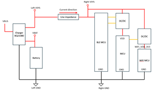

In our smart galsses project, we found that when increasing the load (enable the WiFi function) will cause VSYS to lose power. The application diagram is as follows:

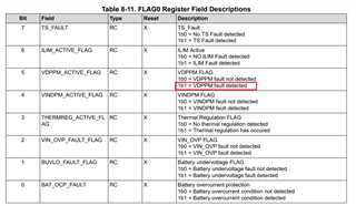

We read the value of each register when the problem occurred and found that the FLAG0 Register displayed VDPPM fault detected.

    I noticed from your register logs that REG0x02=0xA0, which indicates both a TS fault and a VDPPM fault were detected.
    • Could you please share the BQ21080 portion of your schematic?
    From your waveform capture, it looks like VSYS falls below the 1.6V SYS short threshold, which disables the input FET. Once VSYS rises above the 1.6V threshold, the input FET is reenabled, but the SYS load pulls it down again, causing the cycle to repeat. Is this the problem you are seeing?

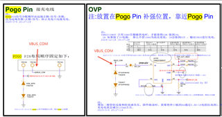

    The schematic is as below:
    Set to VSYS follow battery voltage mode. When the battery voltage is low and the charging current is high, Vin will be pulled to around 4.1V. As the charging current decreases, Vin will rise, but it will occasionally trigger continuous interruptions when fully charged.
    At the same time, we found that when VDPPM is disabled, interruptions are 100% to occur, but after enable it, the interruptions will becomes a probability happens.

  • Hello Lumina,
    Thanks for sharing the waveform.
    It looks like the problem is that VIN is too low during charging. This could be caused by too much voltage drop (IR drop) between the input source and the VIN pin of the BQ21080. When VIN falls below the sleep threshold, the charger considers power "not good" and stops pulling current from the input.
    The sleep threshold, VSLEEP, is 72mV typical. If VIN drops below VBAT + VSLEEP, the charger considers VIN power to be not good, and it stops pulling current from the input. An interrupt is generated when power good status changes.
    At the start of the waveform, VIN and VBAT are both about 4.4V, and VSYS is slightly higher than VBAT - this is expected in battery tracking mode, where VSYS = VBAT + 225mV (typical).
    Just before the first interrupt pulse, the charger likely enters sleep mode. VIN rises to around 5V because no current is being pulled. At the same time, VSYS falls to battery voltage.
    Before the third interrupt pulse, VSYS rises again to its normal level, but VIN drops back to 4.4V and crosses the sleep threshold, so charging stops again.
    This matches your observation that the issue only happens when the battery is nearly full. When VBAT is close to VIN, current that's pulled from the input likely pulls VIN below the sleep threshold.
    To confirm this is the root cause, I recommend testing with a higher input voltage or setting SYSREG to Passthrough mode, which connects VIN directly to VSYS and gives more headroom between VIN and VBAT.
    Let me know if the issue goes away when VIN is higher.
