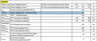

Could you please let us know approximate min/max values for VOVPpos?
Only typical is shown in the datasheet.

Please see the following validation data excel sheets for your query.
Sunstone-PG1p2-K1FCZN_1-BENCH_VAL-data.csvSunstone-PG1p2-R1YHO7_1-BENCH_VAL-data.csv
