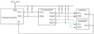

This is my Software and Hardware Setting, I'm not sure is correct or not.
LM3549 I2C device address could not be selected, so I choose the I2C MUX PCA9543.
The hardware connection path is STM32F1(MCU)_I2C2->PCA9543(I2C MUX)->LM3549_Right and LM3549_Left(LED Driver)->LCOS
in the PDF TI_LM3549 pdf, as shown below, This is a part of the LED driver design(hardware is refer from the LM3549 EVK).
TI_LM3549.pdf
1.I pull down the the A0 and A1pin from PCA9543(PCA9543.schDoc,part number U10), cause the I2C devices is only two.
2.As the same page, I use four MOS to prevent the current leakage from I2C slave device to master.(I'm not sure this method is correct or not)
3.In the software control as show below
(3-1)MCU and PCA9543 turned on as the same time
(3-2)pull high the I2C reference voltage for LM3549
(3-3)pull high the LM3549 enable
(3-4)set the PCA9543 for the SD0 and SC0
(3-5)configure the LM3549_Right
(3-6)set the PCA9543 for the SD1 and SC1
(3-7)configure the LM3549_Left
(3-8)Turn off the the PCA9543 to prevent some malfunction

  • Hi Steve,
    For the 2nd point, i'm not very understanding what's the meaning of "prevent the current leakage from I2C slave device to master". And not sure why there is a separate voltage reference, I2C_Ref3V3, for the I2C of LM3549.
    From my understanding, the VCC_3V3 could be used for the reference for all the I2C from the MCU to LM3549 as shown below. As they all share the same voltage level.
    Felix
  • Thank you for your reply, I will correct my misconceptions,
    1.I will change the LM3549's I2C voltage source from I2C_Ref3V3 to VCC_3V3 and remove the U6 buck.
    2.Q1~Q4 is necessary? It seems redundant in this circuit.

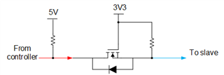

  • Hi Steve,
    For the MOSFET circuit, I have seen it was used for lever shift as shown below to convert 5V logical level to 3.3V logical level.
    So from my understanding, in this application there is no need for the Q1-Q4 circuit.
    Felix
