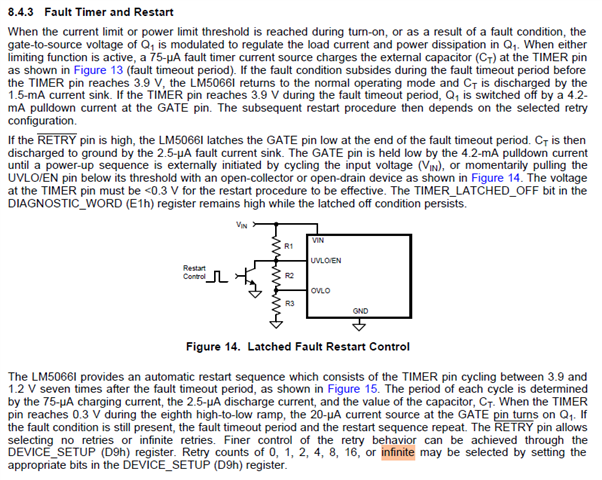

Hi team,
I have a question regarding the fault timer of LM5066I. LM5066I can cahnge the number of retry count from 0 to infinte. What is the infinite? How fo we understand the operation of the retry count of infinite?
