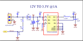

TPS62162: The schematic review for TPS62162
Part Number: TPS62162
We use the TPS62162DSGR for 12V to 3.3V/1A buck circuit, and now, we have about 6% failure in our mass product,
and we test the Pin to Ground impedance and VIN(pin2) and EN(pin3) of the the failure ones are less impedance compare with the good;
We conisder the internal MOSFET are damaged, but we make sure our  Vin voltage is normal;
Can you help to reivew our schmatic and pin to ground impedance, and then advise if there are any error for our design, thanks.
