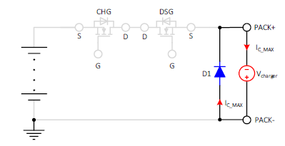

HI team,
In this post it says adding D1 can help with the reverse charger protection. If the charger reversely attached then D1 here will directly short the charger? Then how to protect this reverse polarity charger attach?
What exactly this D1 diode is used for?
