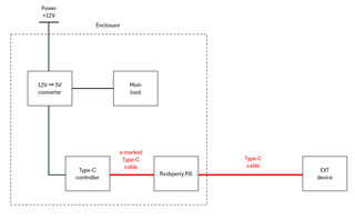

    We are currently developing a device that incorporates the Raspberry Pi 5, as shown in the following URL:
    https://www.digikey.jp/en/product-highlight/r/raspberry-pi/raspberry-pi-5
    Since the Raspberry Pi 5 can consume up to 5V / 5A, its dedicated chargers are typically rated at 5V / 5A.
    For reference, below is a link to one such dedicated charger:
    https://shopstaff.jp/items/B0CX4ZWSML
    The device has an opening that allows external access to the Raspberry Pi 5's USB Type-A port.
    When powering external devices from this port, if the power line supplied to the Raspberry Pi 5 is not a 5V / 5A PDO (Power Data Object), the system will forcibly shut down.
    To prevent this, we are planning to design a Type-C power delivery control circuit on the internal board of the device that guarantees a 5V / 5A PDO, and use it to power the Raspberry Pi 5.
    Below is a simple block diagram of the system.
    Please note that this project is not intended for automotive applications.
    Also, thanks for your suggestion regarding the TPS25751.
    Regarding the PDO configuration method you provided — can everything be completed using the TPS25751 GUI tool alone?
    Thank you in advance for your support.

    Are you looking to power the entire Raspberry Pi 5 board or just the PI 5 chip itself?
    In the web GUI you can configure the Transmit Source Capabilities (0x32) to include a 5V/5A source PDO, however keep in mind this will only work with a combination of 5A cable with a sink device that will request 5V/5A.
    Let us know if you have any further questions or concerns!
