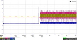

The inrush current comes out too high when starting up.
Is there any way to improve it?
The schematic cannot be disclosed for security reasons.
Can you tell me how I can deliver it personally?
Input:15V
Output:24V 3.5A
*Waveform
CH1 gate
CH2 Drain Voltage
CH3 Drain Current

    In a boost topology, input and output are directly connected with each other through the inductor and the high side MOSFET.
    Even if the MOSFET is turned of, current can flow from input to output through the body diode.
    If you turn on the power supply at the input side, the output voltage will charge up to the input voltage level, even if the controller is not active yet.
    This creates a strong inrush current which cannot be avoided.
    It would be necessary to disconnect the input from output side to avoid this inrush.
    The LM5121 device is from the same product family as LM5122, but has a disconnect switch, which slowly turns on during power-up to reduce this inrush current.
    Unfortunately, switching the controller device would require a layout change.
    Please let me know if there are additional questions on this.

  • Hi David,
    If customer confirmed that this inrush is coming just from turning on the power supply, I see no way of optimizing the design without layout change, as this inrush is not related to the controller.
    They could stay with LM5122 and implement an external circuit that limits the inrush current during turn-on.
    If there is a possibility for their system to slowly ramp up the supply voltage, this would also reduce the inrush current.

    The inrush current occurs before the IC starts switching, and the inrush path seems to be:
    input → inductor → FET body diode → output capacitor.
    In this case:
    1. Is it appropriate to apply the FET’s body diode ID pulse rating to evaluate the stress from this inrush current?
    2. Also, if the inductor exceeds its saturation current rating (approx. 30 A) just once briefly during startup,
      would that be acceptable or could it lead to potential long-term reliability issues?
  • Hi David,
    You are correct.
    There is no protection against this sort of inrush current on the EVM.
    Also in the failure case the the output is shorted, there is not protection implemented, as the controller cannot do anything to block this current path.
    The risk of damaging the inductor is small.
    If an inductor saturation, the inductance reduces until the inductor behaves like a short circuit.
    Once the current reduces, the inductor recovers and there are no long-term reliability issues.
    The MOSFET would be the weakest part, because it can break if it heats up too much from the current through the body diode.
    However, as the inrush only occurs for a very short time period, there is no damage seen in most cases. (This depends on the MOSFET component, but I am not an expert on this field)

    I’m currently evaluating the CSD18543Q3A MOSFET, and during system startup, the body diode sees an inrush current of 121A lasting approximately 120µs (single event).
    Since SNVAA86 focuses on steady-state dissipation and continuous current, I’m unsure if the following pulse energy method I found online is technically valid for a single-shot inrush condition like mine:
    E = I × V × t = 121A × 1.0V × 120µs = 14.52mJ
    Then, comparing that to the datasheet’s EAS rating of 55mJ, the stress is about 26% of the maximum.

    EAS is avalanche rating which is very different from pulse current. We can use the normalized transient thermal impedance graph in Figure 1 to estimate the junction temperature rise due to the pulse. For simplicity, assume VSD = 1V:
    ΔTJ = PD x RθJC x ZθJC = 121W x 1.9°C/W x 0.1 (from Figure 1) = 23°C
    It should be OK as long as TJ < TJMAX. You can also use this graph for repetitive power pulses as shown in the app note below. I've included a link on pulse current ratings. Let me know if you have any questions.
