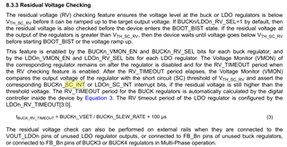

    When does this error occur, on power up, during runtime, when going into shutdown, more details would be appreciated, and even more if you have oscilloscope captures relating to LDO1/LDO3.
    Also please see the below for one of the causes of SC_INT on an LDO resource.
    BR,
    Nicholas McNamara

    As you suggested, it took time for the voltage to drop when the LDO output was turned off, and the residual charge exceeded the threshold.
    I was able to resolve the issue by masking the interrupt.
    Thank you.
