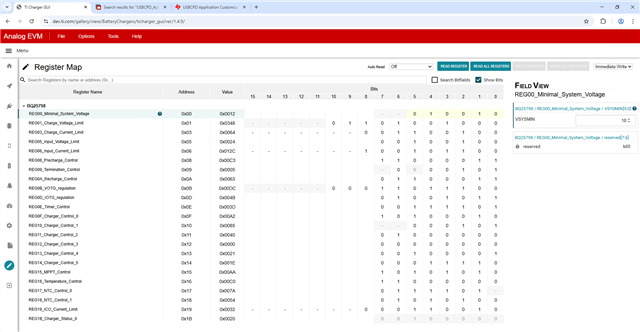

Hi Team,
I encountered an issue while using tps25751 (PD) to read bq25798 (charger) data through IIC; The problem is as follows
(1) When I read the value of the 0x01 register, the default value I read is 0x0348, which is the same as the value on its Register Map. After writing data to the register and reading it again, the result is also correct, as shown in "0x01_log. txt"
(2) However, when I read the value of the 0x0A register, the default value I read was 0x0063, which is correct. After writing data to the register and reading it again, the result is also incorrect, as shown in "0x0A_log. txt"
(3) When I was reading the value of the 0x03 register, the value I read was 0x000F, which is inconsistent with the value on its Register Map. I then wrote data to the register and read it again, and the result was the same as the written data
I don't know why situations (2) and (3) occur. Could you please help me identify the problem? The code is shown as "readw_rite_code, txt".

  • Hi Iris
    What do you mean by default value here?
    Can you capture and provide a trace log of the I2C lines for the failing case?
    I'm still reviewing some of your logs, but is there supposed to be an I2Cw payload here?

  • Hi Chris,
    I found through analyzing the data captured by the logic analyzer that PD automatically writes data to the charger's register when powered on. Then I read the value of the charger's register, which is consistent with the PD configuration, but not consistent with the value in the register map table. In this case, which one should be used as the reference standard?
    Writing to registers is also okay, I ignored the valid position of each register
    (The file captured by the logic analyzer is in the compressed file uploaded to the LAN. You need to install the "KingstFIS-v3.6.4. exe" tool in the compressed file first, and then open the file)

  • What do you mean by default value here?
    Hi Chris,
    The default value here refers to the value value corresponding to each register in the register map, as shown in the following figure
    Best Regards!

  • Hi Iris,
    Yes, as you noticed, the TPS25751 will program some of the BQ25798 registers on boot, so they will not necessarily be in the default state according to the BQ tool.
    You should expect these register to be modified and use the PD configuration writes.
    On bootup, the TPS25751 modifies registers 0x01, 0x03, 0x08, 0x09, 0x0b, 0x0d, 0x0f, 0x10, 0x11, 0x12, 0x14, and 0x2e.
    During normal runtime, the TPS25751 will write and modify other BQ registers to configure it properly regarding operating mode (source/sink), power, voltage, and current level, and connect and disconnect states.
    Thanks and Regards,
