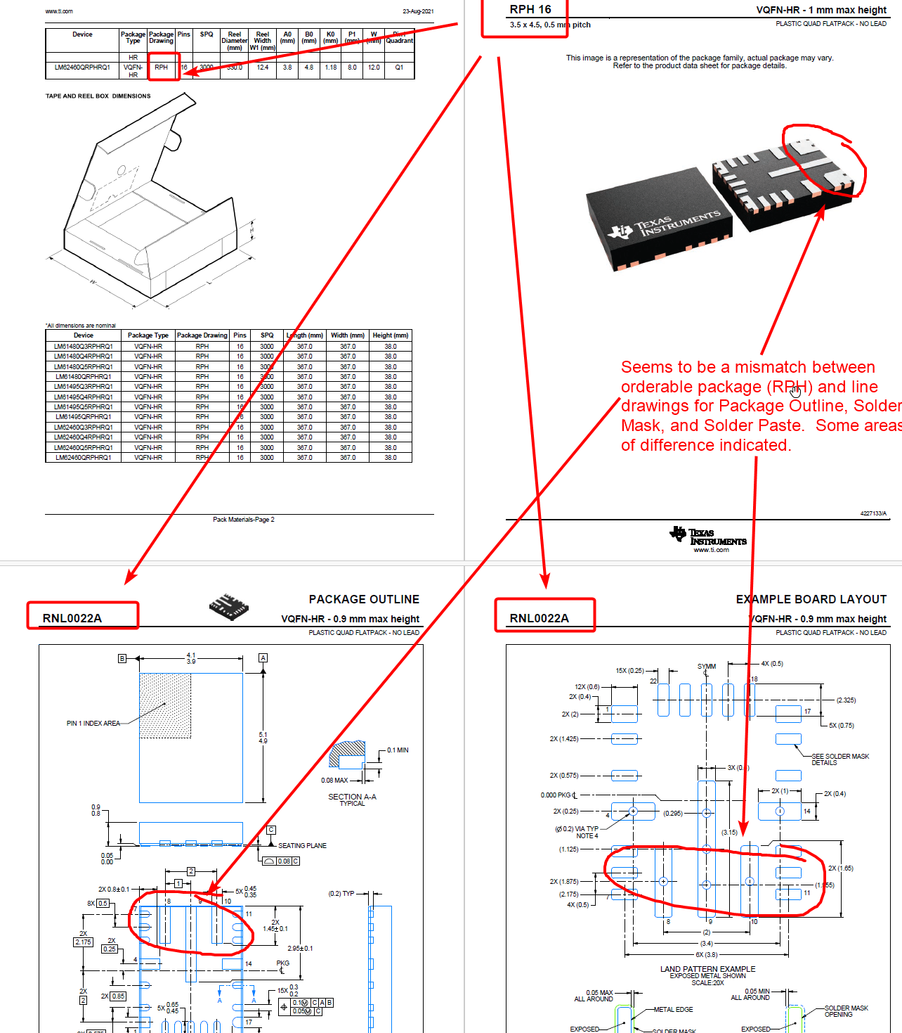

Are the package outline, solder mask, and solder paste drawings for RNL0022A correct for LM62640-Q1?
Thank you for pointing this out, we are working on fixing this. In the meantime, you can get the proper footprint on the Ultra Librarian link on the product's page.
