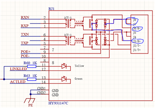

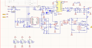

Could you please help me take a look at this picture? Is there any problem. We found that the standard POE power supply equipment is connected here, but there is no output.
My first time using this chip, my previous experience tells me that the handshake may not have passed.
Please help me review this schematic and provide some possible reasons for the lack of output.

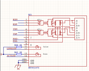

    It looks strange that PR78 & PR36, PR12 & PR45 are grouped together. PoE normally Alt-A is PR12 & PR36 as a group, Alt-B is PR45 & PR78 as a group.  You may try to correct the pairs combination.

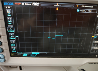

    Besides, can you capture the waveform at C75? Want to see if you can get a waveform like below (10V/div)

  • This is an integrated Ethernet connector, not a discrete schematic diagram.  It is a schematic diagram describing the internal connections.  The Ethernet connector contains an isolation transformer and a rectifier inside.  This Ethernet connector is fine and normal.
    C75,The test waveforms are as follows (1V/div).
    The maximum voltage is only 0.5V

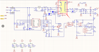

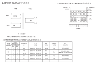

    Besides, the TI transformer did not adopt the one officially recommended by TI. I'm not sure if there will be any problems.

    Based on the waveform, the detection could already have an issue. I would recommend you to double check if PR12 & PR36 is grouped, PR45 & PR78 is grouped. If PR78 & PR36, PR12 & PR45 are grouped as the circuit showing, the PoE won't work.
    The transformer winding bias looks ok to me.
