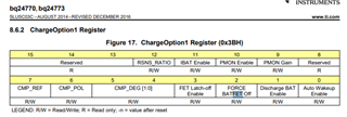

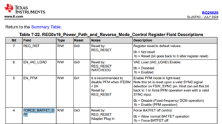

  • Hi Jose-san,
    1. Is my understanding correct that the way to check that the FET is on is to read the corresponding register with I2C? If so, which register should I read?
    2. Also, could you tell me how to turn the FET of the gauge on? I found the register "FORCE _BATFET_ OFF," but I did not know the register to turn it on.
    Nishie

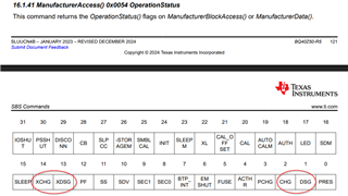

    To read from BQ40z50 register for CHG FET, please use OperationStatus() register.
    CHG/DSG bits indicate FETs are ON.
    XCHG/XDSG bits indicate FETs are off.
    The snippet you attached looks for the charger device. Please use gauge TRM for this info.

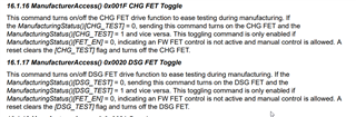

    The gauge's firmware controls the FETs if FET_EN is ON.
    When FET_EN is OFF, the user can send the CHG FET TOGGLE command to toggle the FET. Note that this is only recommended for testing purposes (FET_EN = 0)
