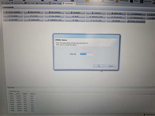

BQ27Z558: Error in creating golden image file
Part Number: BQ27Z558
Hi, team.
I have finished learning cycle of BQ27Z558.
Since my battery is not fully unsealed, creating image file has failed as below image.
Could you let us know default UNSEAL_FULL_ACCESS key and UNSEAL Key?
Thanks for your supporting.
  • Hello Jaiyong,
    Please reference section 12.8.19 AltManufacturerAccess(), a screenshot has been attached below. However it is possible that your team has already changed the security key and it is something you would need to find internally.
