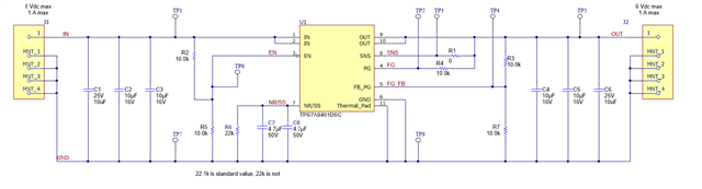

Hi Sir,
Regarding the output from TPS7A94 device, we need 0.5V output, but i am getting 2.2V.
I have used below schematic diagram for the reference.
I have changed the R6 value from 22k to 3.3K for the output of 0.5V.
Could you please provide the proper values to get the 0.5V output from TPS7A94 device.
Kesav
  • Hi Kesav,
    Your chosen 3.3k R6 value should provide 0.495V at the output.
    Do you have a schematic for your design aside from the EVM schematic above?
    If not, I have a few questions - what is Vin in your application? Is SNS connected to vout?
    Can you confirm voltages at the following points: Vin, Vout, NR/SS (across R6 in the schematic above), pin 8 (SNS) of the LDO.

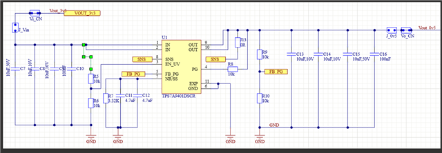

  • Hi Alex,
    Thank you for your reply.
    Please find my comments below in blue color.
    The below is the LDO board schematic diagram.
    I have used EVM schematic for my requirement only changed the R6 value
    Yes, SNS is connected via zero ohm resistor. Vin is 3V
    Vin : 2.759V
    Vout : 2.212V
    NR/SS : 2.211V
    at Pin 8 : 2.211V
    Please provide the correct values to get the 0.5V on output.
    Kesav
  • Hi Kesav,
    I would suggest double-checking connectivity on R7 - with 2.211V on the NR/SS pin, the output voltage of 2.211V is correct. The high voltage at the NR/SS pin suggests that R7 isn't the correct value (3.3kΩ, as you calculated), or that it's damaged or not connected.
