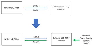

Dear Support-Team,
unfortunately I can't resume the conversation with Aya Khedr regarding TPS25751 / TPS25763. The following block-diagram shows the intended design.
My questions:
1. If only USB-Data is transfered to the Monitor and back (The monitor is equipped with additional USB-Hub-controller) the TPS25751 would be the best choice - can you confirm?
2. If in addition to the USB-data also DP via alternate-mode is required in the monitor-side, I would use the TPS25763 - Can you confirm?
3. Is there a possibility to update the firmware of the TPS257xx in the field (be end customer) via USB, or would I have to add a MCU connected to USB which  updates the TPS257xx over I2C?
    No.  The TPS25751 does not support USB3 data.  The connection manager status is not available.
    You would need to use an MCU to update the TPS25751 over I2C.

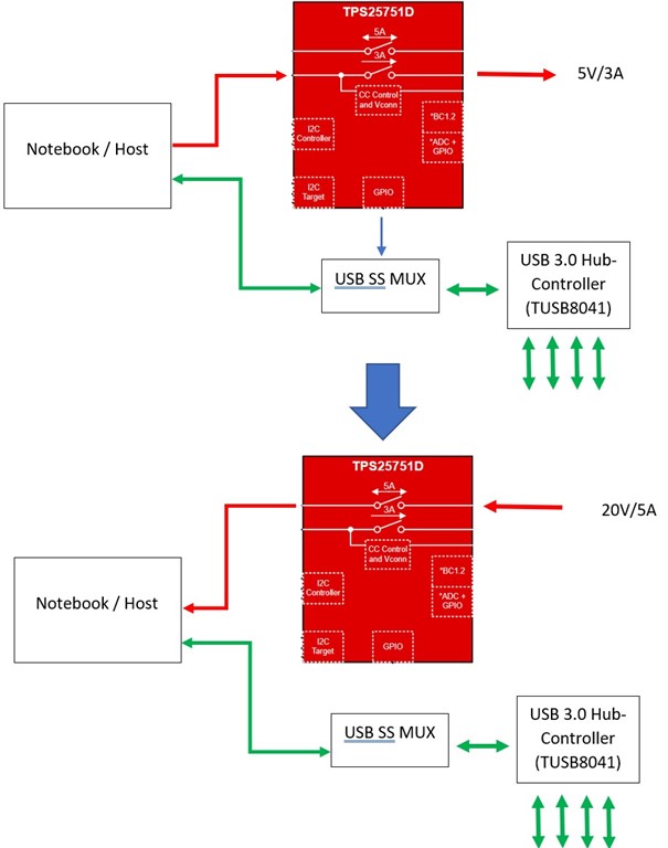

  • Hello Chris, hello Eric,
    according to the datasheet the TPS25751-D is Power Role: DRP, Sink and Data Role: DFP, DRD, DRP so according to my understanding it should be possible to use the TPS25751-D in the following application:
    Therefore I don't understand what you mean saying: "The connection manager status is not available"
    BTW: Up to now I was using the TPS65987, but unfortunately it is no longer recommended for new designs.
    Looking forward to your Feedback.
    Best Regards
    Norbert
    Yes.  The TPS65987 supports alternate modes and the USB3.0 communication.  That is the PD identifies the alternate mode communication and makes this information available to the MUX or embedded controller so that the mux can be updated correctly based upon the connection.  The TPS25751 does not have this capability.
    The data roles are limited to the D+ and D- described above to support BC1.2.
    Chris

  • Hello Chris,

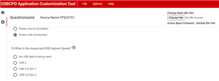

    I would like to get back to your answer below: "No.  The TPS25751 does not support USB3 data.  The connection manager status is not available."
    I checked again the datasheet  and on page-47 and page-48 it seems like the the connection manager is available. In addition I checked the "Advanced Configuration" in the "USBCPD Application Customization Tool" and in the section "IO Config" you can select "plugevent_port1" and "cable_orientation_event_port1". Therefore I don't understand why there shouldn't be a connection manager.
    If I'm right, could I use the TPS25751 for the application I described (see block-diagram) at the beginning of this thread?
    Thank you very much
    Norbert
    You are correct and I was mistaken.  The TPS25751 does support USB3 data.
    Chris

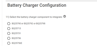

  • Hi Chris,
    sorry to bother you again. Regarding the application, shown in the diagram above, do you see any problems regarding the power-switching (DRP) 5V/3A to 20V/5A?
    Thank you
    Norbert
    No bother.  The TPS25751 will not have issue with the power role swap.  Please be advised that the device is configured in the context of a battery charging system and is pre-loaded with I2C events to configure the charger (BQ device) when transitioning to battery charging to OTG (sourcing).
    You can also choose to not have a battery charger implementation you would just need to manage the sink and sourcing of power on the other side of the TPS25751.  I hope that is clear.
    Chris

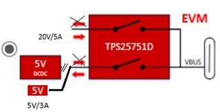

  • Hello Chris,
    thanks a lot for your answer and links. As shown in the initial block-diagram I would like to use the TPS25751 in a monitor which either sinks 5V/3A from a notebook, or - as soon as the monitor is supplied externally - it should act as a source and charge the notebook (up to 20V/5A). The power-role swaps must be seamless in order not to interrupt the USB connection. As far as I can see in the schematics of the evaluation board (PMP41062) the setup in the diagram below should be posssible.
    If this is not possible, do you have any reference designs for a seamless power role swap?
    Thank you
    Norbert
    Agreed.  The power role swap occurs as defined in the USBC-PD specification.
    Chris
