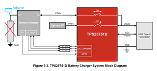

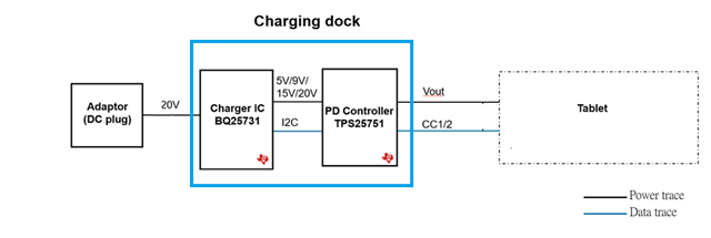

I have a project about  a charge Docking(Blue block) . My BlockDiagram as Below
There is a adatper supply 20V to Docking ,then we can put tablet on docking for charging

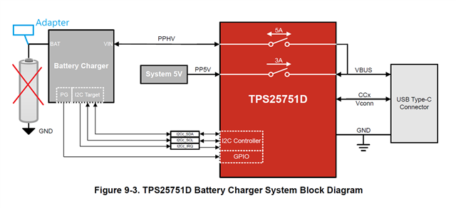

I  want to make sure how to connect VIN side and VBAT Side of Charger IC BQ25751
how about the block diagra as below ,is it right??  if it`s wrong,please share a right Block diagram ,thanks
  • we try to use the BD as below capture ,we find the VBUS of type-C connector  is  0~5V  up and down  ,it can`t be stable as 5V
    Do you have any idea about this situation ??
    BTW ,the adapter is DC-IN adapter ,it`s not type-C adapter.

  • Hello Sky,
    I'm confused as to the application. It looks like the customer needs a DC-DC converter to dock the tablet.
    The BQ25751 is a lead-acid battery charger. Does this application have a battery? Are you referring to the BQ25758A? The BQ25758A is a DC-DC converter that can support 20V input and 5/9/15/20V output.
    If your system was referring to the BQ25758A, the TPS part and the BQ part will need to swapped around.
