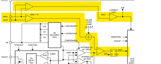

I saw R12 and C22 on the current sense circuit from EVM as below.
What is the purpose of this circuit ?

Hi Hank,
The resistor is for inductor current sensing that is utilized for Peak Current Mode Control. You can see that in the functional block diagram as well:
The capacitor is just there for filtering.
