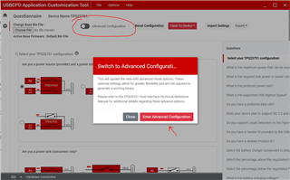

    We didn’t find this option in the Web-based GUI. Is it possible to implement this function through the pre-configured firmware in a no-MCU design?

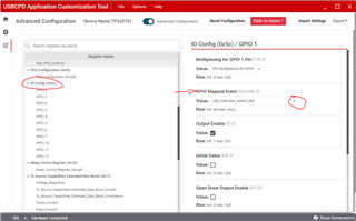

    To configure the GPIO pins in the web-based GUI, enable "Advanced Configuration" as shown below:
    This will open up the entirety of TPS25751 Host Interface, scroll down to find IO Config (0x5c) and select any GPIOs you want to configure. Once you select the GPIO, click on the drop down menu for the events and select the UFP event. In the example below, GPIO1 is now set to ufp_indicator_event (44).
