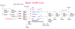

We are currently designing a circuit using the TPSM843521, and would appreciate your help reviewing our schematic to ensure there are no obvious mistakes or issues.

HI Tom,
2 suggestions:
1. Add a RC at FB as below:
2. Increase output caps to 2nos 22uF.
