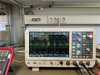

I am working with a DC/DC converter with the above values. My R_tmin resistor has a value of 12k. I have no problems with output regulation. I have loaded up to 1, 5 and maximum 14 A. However, I cannot get out of burst mode at all load values. For this reason, there is an audible noise in the 10 kHz band from the pickups. I did not do the load tests I mentioned for more than 10 seconds. If I continue, something will be damaged. How can I get out of burst mode? Where is the error?

    Thank you for your answer. I will try this. Can it be situation which created by CS pin or hiccup mode because oscilloscope view seems like hiccup mode. However, if power transformer works resonance frequency, input current can increase and this situation can cause current error. Can this situation realize ?

  • Hi Cihangir,
    Transformer leakage inductance, shim inductance and Coss of FETS will be in resonance during deadtime and that is the expected behavior, and I don't see any issue there.
    To make sure that it is a hiccup mode trigger and not a burst mode trigger. You can disable the hiccup mode by connecting a 261kOhm resistor between SS and Vref pin. This will disable the hiccup mode and latch the overcurrent protection. In this way we can confirm whether it is a hiccup mode or a burst mode operation.
    You can also measure the pulse width of the controller PWM out and check whether it is equal to Tmin, if it is equal to Tmin then it is most likely controller operating in burst mode and if it more than Tmin then as you mentioned there is a chance of hiccup mode instead of burst mode.
    Deepak K

    After separating the electronic load and repeating the test with a resistive load and getting the same result, we made changes to the output capacitors. By the way, yes, the frequency I mentioned is the switching frequency (the ripple frequency of the output filter). However, at this stage, we still haven't completely solved the problem. I don't think it's normal for the sound to go away after 50% load. It's not certain that this situation is completely caused by high capacitance because when I reduce the output capacitance to 4 uF and repeat the test with a resistive load, the sound stops after 50% load and output regulation is provided. I don't have the infrastructure to measure frequency response, but I think that type 2 compensation is not sufficient. However, when I work at an input voltage value where output regulation cannot be provided, that is, when I work in a situation where the duty cycle is guaranteed to go to maximum, the sound stops. I continue to analyze the situation, your opinions are valuable to me.
    Best regards.
