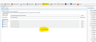

Please reference the image below for exporting golden image from bqstudio.
Thank you,
Alan

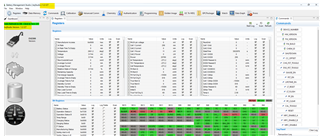

Hello Alan,
Thank you for your reply. I do not see the golden image tab in my bqstudio.
Do you know what maybe the issue?
Parikshit

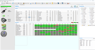

Hi Alan,
I tried updating and even after the update there is no tab for Gold Image.
My device is BQ78z100 and it is at its latest firmware.

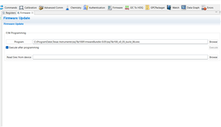

You can read the image for this particular gauge with the "Firmware" option. This gauge uses the .srec format. You will get the Golden Image when you export the .srec file with the "Firmware" option.
Hi Dominik,
I believe that when one selects the "Firmware" option, the Gauge can only be programmed and there is no option to Export the .srec file. Can you please elaborate and help me understand if I am missing something?
Parikshit
Choose "read srec from device". It's the bottom line (there are two lines in this window).
