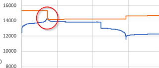

Please find the attached log file for full charge capacity issue.

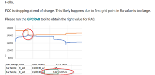

FCC is dropping at end of charge. This likely happens due to first grid point in Ra value is too large.
Please run the GPCRA0 tool to obtain the right value for RA0.

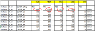

And I tried to analyse and compare the default chemID files(Just loaded the chemId and read the GG.csv) which we have used so far as shown below and attaching the excel file.
Except chemID 4206 for all others the RA0 value is very high value. Please analyse and help us in correct value for the Ra table values.

For ChemID 4121 - the report shows - Ra0_ch, mOhm : 85. Why not use this value?

As per our conversation the suspect raised on the first value of Ra0 is high, that could be causing the FCC jump as per below,
So, I tried comparing all the Ra table values of the default CHEMID files, All are having the first value high.
Is that expected? Do we need to use the always the GPCRA0 Ra values for production?
Finally, as per the discussion and testing we understand that the Ra table calculation could be causing the FCC jump. So, we would like to understand the solution for the production?

That is correct. Please use GPCRA0 tool to prevent FCC jumps at End of Charge.
