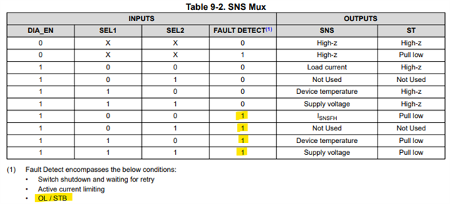

  • Hey Sadheedh,
    It looks like the high side switch is in an open load state. Are you able to test with a load to determine if VOUT will rise. In addition, can you probe ST and see if the device behavior correlates with the SNS mux table in the datasheet to determine an open load FLT.
    BR,
