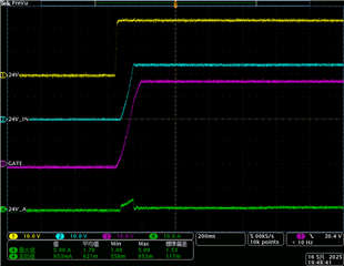

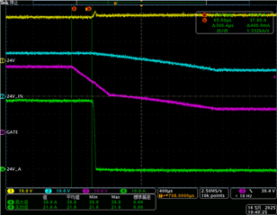

    We checked the waveform by turning Enable on and off 700 times.
    The waveform at 100nF is shown below.
    When Enable is OFF, the current does not rise again.
    CH1 (yellow): DC24V INPUT
    CH2 (light blue): Voltage after FET
    CH3 (purple): Gate voltage
    CH4 (green): Current
         Fig.1 Enable OFF waveform
     Fig.2 Waveform when DC24V is turned on
    I see an inrush current of about 5.4A, but I don't think it's a problem. I think it will be reduced if I increase the capacitor capacity.
