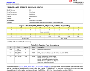

i am using TPS546D24S for 2 phase stacking. i have made changes based on the datasheet. i am doing configuration for controller and follower by using PMBUS communication. the configuration for controller and follower for stack config , interleave is as follows
controller
interleave - 0x0020
stack config - 0x0001
Follower
interleave - 0x0021
as i read the datasheet it is mentioned that other configuration follower will take from controller. and i have changed the address of follower as well to 0x01. my issue is i am getting bcx error what could be the possible reason any other register i need to configure. Thanks in advance for any help

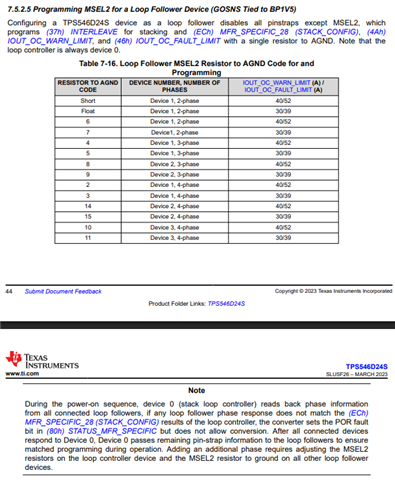

    First, check that the follower device has its GOSNS pin connected to BP1V5. This connection makes it a follower. If the GOSNS pin is not connected to BP1V5, it will act as a stack controller.
    Next, make sure the MSEL2 pin programming on the follower device is correct. This programming sets up the INTERLEAVE for stacking, along with STACK_CONFIG, IOUT_OC_WARN_LIMIT, and IOUT_OC_FAULT_LIMIT.

    1. Thank you for your response. I have checked that in follower gosns pin is connected to bp1v5. And for configuration of MSEL2 I am not using pin strapping method I am configuring it by pmbus communication protocol. For schematic details i have make MSEL1,MSEL2,ADRSEL,VSEL in controller as float and in follower MSEL1,ADRSEL,VSEL connected to AGND as per the datasheet.
    2. For all configuration I am using pmbus communication. I am writing my desired values in register directly.
    3. For stacking I am configuring STACK_CONFIG, INTERLEAVE in controller and follower as I mentioned earlier in controller INTERLEAVE as 0x0020 and stack_config as 0x0001. And in follower INTERLEAVE as 0x0021 and stack_config as 0x0001(here I am confuse as it to make it as 0x0000)

    If this is the case, did you make sure to change the PIN_DETECT_OVERRIDE register to reset to NVM and not reset to the pin-detect value?
    STACK_CONFIG should be 0x0001 for a 2-Phase.

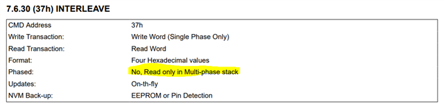

    1. Is there any other register that i need to program for stacking apart from STACK_CONFIG and INTERLEAVE like SYNC_CONFIG?
    INTERLEAVE is Read only in Multi-phase stack. No need to change SYNC_CONFIG. No other register need to be changed.
