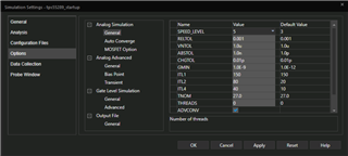

  • Hi
    I cannot locate root cause without your model file. Please try adjusting simulation setup like below. This will reduce accuracy but improve convergence. If this doesn't help, there's nothing I can do without your simulation file. (I'm using another model as an example, please neglect the file name TPS55289)
    Travis
