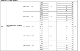

Thanks Elizabeth. So, if I want to calculate power (P=I^2*R), and in this particular case for recommended operating conditions I_max = 6A, what should I use for R? Is it 45mOhms, 87mOhms, or something else? Thanks for your help!

A power dissipation calculation would use R_ON, but that spec changes based on operating condition and temperature.

Regarding R_ON, the worst case for power dissipation would be with the highest R_ON from the datasheet spec.

I have also found that our thermal model used the following:
Iswitch^2 * Rdson = 6^2 * 0.087 = 3.132 W (@125C)
