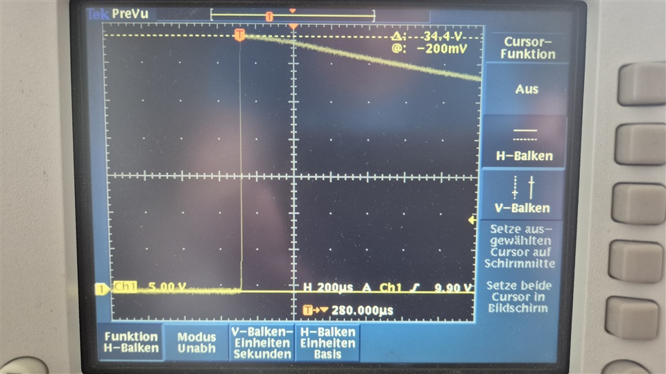

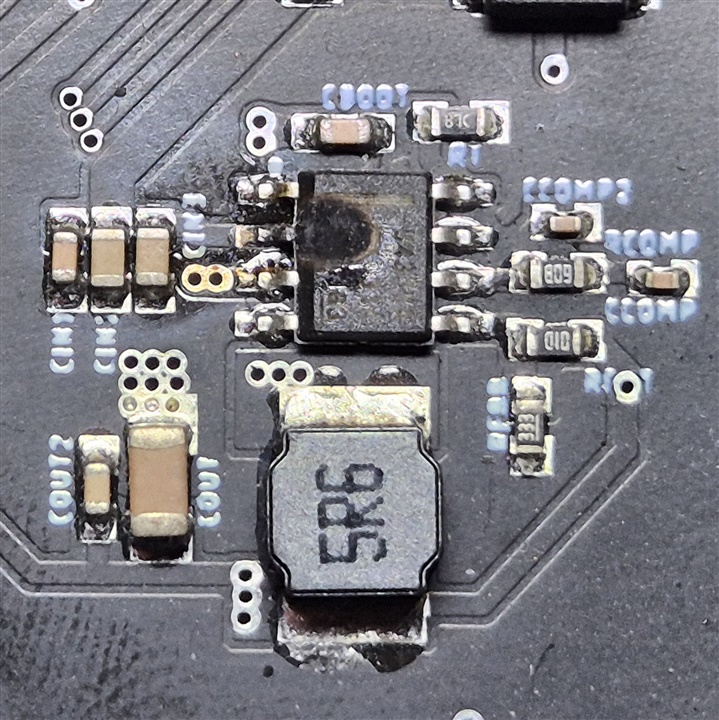

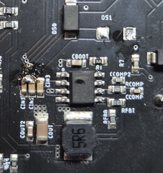

Hello, I wanted to install the chip in a motorcycle to supply power to an ignition control unit. I was previously using the MP1584EN without any problems. The chip seems to work at first. However, it can sometimes suddenly burn out when turned on. I'm a bit confused as to what's happening. It might be something when turning off. I'm also using protection diodes at the input. Does anyone have any ideas? Below the used circuit. The protection diodes D50, D51 have a value of 40V (SS34).
