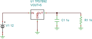

  • Thanks, I downloaded the model.
    It's for a fixed 3.3V output.  I need the 5V part.
    Looking at the model text, I would suggest for these fixed output devices you simply make the output voltage a parameter- that way you don't have to release a model for every single version.
    I think I can figure out how to modify it for 5V, but some hints would save some time, but it appears these two lines are setting the output voltage:
    R_U1_R1         U1_N222934 U1_N287997  168k
    R_U1_R2         U1_N283278 U1_N222934  30k
    It's pretty straight forward to give the TPS7B9x sub circuit a PARAMS: VOUT = 5 and then compute R1 inside the model.
    There are no notes/header at all describing what's modeled, or what's not... very odd, usually these models are better documented.  Is a new version on the way?

  • Attached is the parameterized TINA macro with adjustable VOUT.  If you give me some hints on how to adjust the current limit that can be implemented, too.
    TPS7B92.TSM

  • Hi Steve,
    Thanks for sending the macro! We have plans to extend and improve our models in the future, but I can't provide a specific timeline on that effort, unfortunately. Parameterization along the lines of what you propose may be something we incorporate into future modeling efforts - it would certainly be more convenient to allow different output voltages to be configured that way.
    I'm not aware of plans for a 2.5V version of the TPS7B91 at present. I've passed on the request to our systems and marketing team to let them know there's interest, however.
