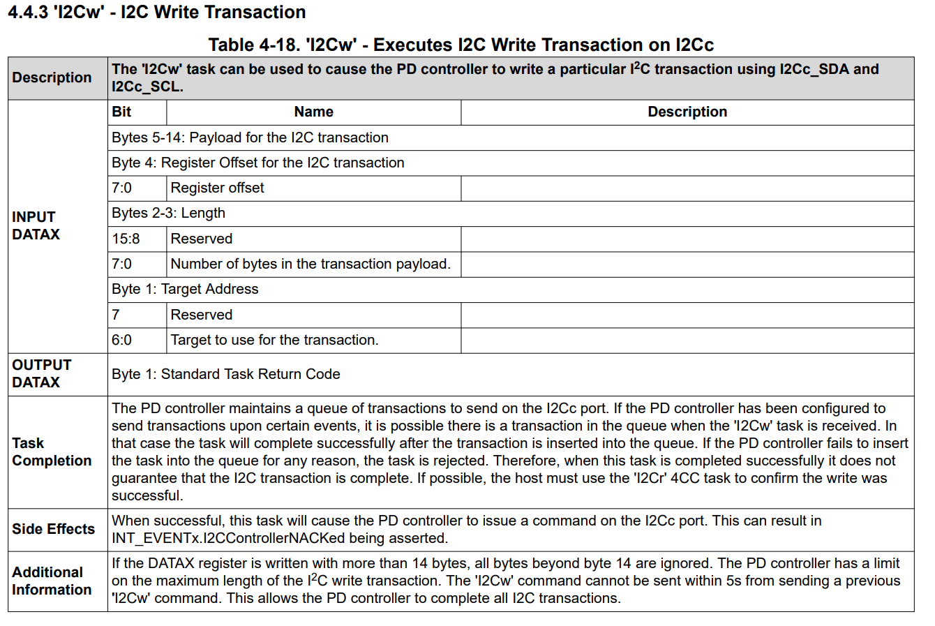

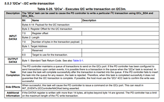

We are investigating a 4CC task for the TPS25751.
We performed the I2Cw commands exactly as described in the TRM, but they did not work as expected.
After trying various things, I found that setting INPUT DATAX as shown below worked as intended.
Byte 4 : Data
Byte 3 : Command
Byte 2 : Write byte length
Byte 1 : Slave address
The description in TRM is different from the INPUT DATA X we tested above. Could you please tell me your opinion?
