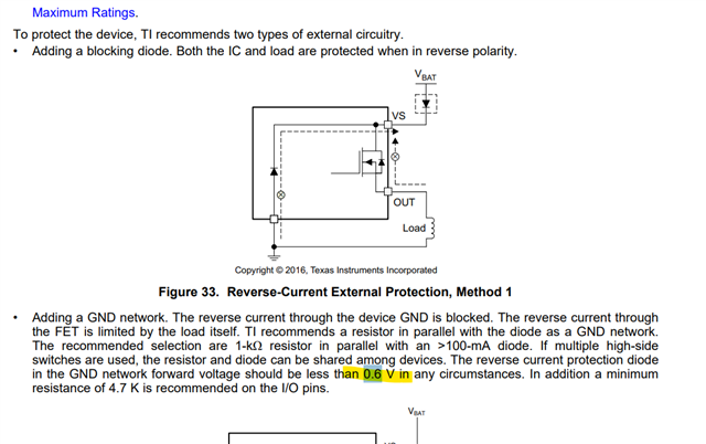

I would like to check with you how to calculate the resistor(R839) and diode(D54) value for loss of GND protection circuit?

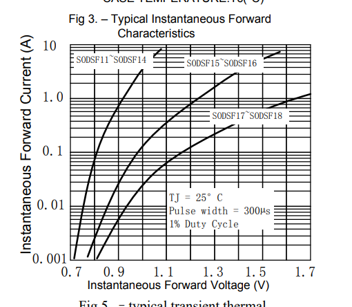

    The resistor is fine- but the diode is going to risk triggering the loss of ground protection. The forward voltage drop needs to be <=0.6:
    ... and it looks like the forward voltage drop of this diode is significantly  higher:
    You can estimate about 10mA of current maximum.

  • Ethan,
    It has to do with the way loss-of-ground is detected in the TPS4H160-Q1. For that device, there is a comparator that will compare a digital low signal with the potential on the IC ground. If it is greater than 0.6V (plus some margin), loss of ground protection is triggered. For TPS4HC120-Q1, the loss-of-ground mechanism was changed so the device does not have this limitation.
    The resistor is there for loss-of-supply + inductive turn-off scenarios. If the resistance is too high in this case, the current will not have a path to go. I misread your schematic- you should have 1k. With a 10k resistance it's possible that during a loss of supply + inductive turn-off scenario, the resistance would be too high-impedance and the current would rather go through the MCU's ground (or something else shared on the ground plane).
