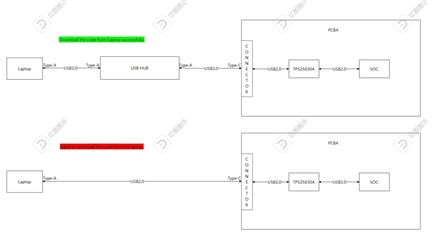

TPS25830A-Q1: When TPS25830A in client mode,the SOC failed to download the code from the laptop.
Part Number: TPS25830A-Q1
After adding a USB HUB between the computer and the PCBA,the SOC download the code from Laptop successfully.
The connection topology is shown in the following figure.
Could you please help analyze what caused it? Can it be solved by optimizing the peripheral circuits of the TPS25830A?
