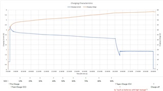

I use TPS26750 & BQ25756 for charging and discharging 14s Li-ion battery on USB-C PD3.1 240W(48V/5A) sysytem.
When charging the battery,CV mode start from 3.1A(CC mode),but CV mode changes to CC mode(1.8A) at 1.5A
(setting of termination current is 0.3A).
I suspect that the cause is the high leakage current of the battery as stated in BQ25756 datasheet(8.3.4.6 CV Timer).

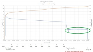

    The problem is that the charging current during Taper-Charge doesn't drop to the termination current,
    but becomes a constant current halfway through.
    (The part in the green frame in the charging graph below.)
    IF this charging process is normal, then there's no problem.
    This charging process is not normal and I haven't seen this problem before. I think the battery's circuits might be messing with the charge process here.
    I've got a few questions for the information in the green frame:
    • Is the battery voltage still rising while the charger is in taper charge?
    • Can you measure the voltage on the VFB pin while the charger is in taper charge? Make sure the charger is off before you connect the probes to VFB. VFB is susceptible to interference when probes are connected to it.

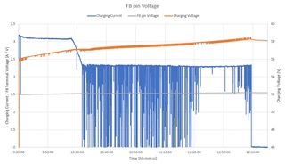

     > Is the battery voltage still rising while the charger is in taper charge?
     As can be seen from the graph, the battery voltage(=charging voltage) continue to rise until charge termination.
     > Can you measure the voltage on the VFB pin while the charger is in taper charge?
     Please refer to the graph below.
     Since the VFB pin is directly connected to the logger input(input resistance=1M), this is likely to be different from the actual operation.

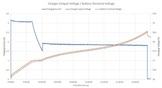

  • Hi Ethan Galloway,
    > Can you measure the voltage from the output of the charger to the battery terminals?
    I measured the output voltage of the charger and the terminal voltage of the battery.
    I have confirmed that the same display is shown at the same measurement point for each logger input channel.
    This voltage difference is likely due to the resistance of the connector(CN3) and connecting wires(AWG18_50mm x 2).

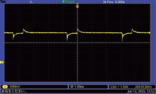

    > Can you measure the VFB pin with a dedicated voltage meter or oscilloscope to see if there is noise on this pin?
    Please refer to the diagram below.
    Ken18
  • Hello Ken18,
    Thanks for the new information. Let me know if the circuit works with the battery manufacturer's suggestions.
    The noise on the FB pin is strange. You may be able to improve this behavior by installing a 100pF filter capacitor in parallel with the top battery feedback resistor (R3,R9,R13).
