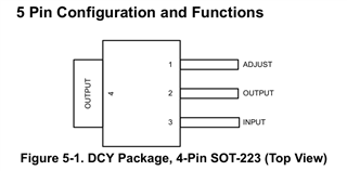

The pin information in the datasheet appears to be inconsistent.
Could you please clarify which one is correct?
Hello Tae,
Thanks for your message. It looks like the pinout from figure 5-1 is actually the bottom view and needs to be corrected. The pin location from figures 8-23 & 8-24 show the correct pinout from the top view.
