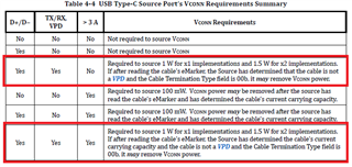

    Please see Section 10.3.16.5 in the TPS25830A-Q1 datasheet for details on how the POL pin can be used to control the TUSB542's SEL pin.
    Also, Table 4-4 from the USB Type-C Spec R2.4 shows that VCONN must source 1W VCONN for single-lane USB 3.2 and 1.5W for dual-lane USB 3.2 communication.
    As stated in Section 10.3.5 VCC, VCC_UVLO of the TPS25830A-Q1 datasheet, "In applications where VCONN support is required, the VCC pin can be over-driven with an external 5-V LDO capable of sourcing at least 300 mA. In this operating mode the external LDO is the source for the buck low-side switch gate drive as well as power to the internal VCONN mux.
    Note if using external 5-V LDO for VCONN power, the timing sequence below must be required. External VCONN power can not be enabled before the TPS2583xA-Q1 is enabled, external VCONN must be disabled before the TPS2583xA-Q1 is disabled. In a real application, customer can tie the EN of external 5-V LDO and EN of TPS2583xA-Q1 together to meet the timing requirement."
    However, despite the USB Type-C specification, I have supported customers who have reported that USB 3 communication was successful without externally driving the VCC pin to source 1W or 1.5W VCONN. If the customer is building an evaluation board, please advise they add provisions for an external LDO to test with and without an external 5V 300mA source.
