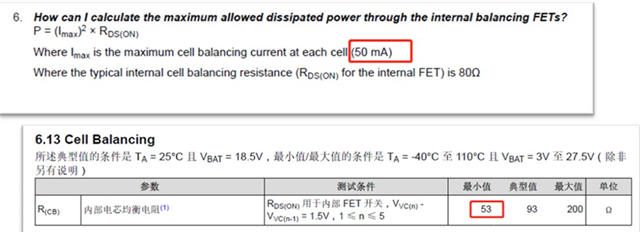

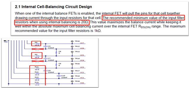

1. The technical manual mentions that the minimum input filtering resistor is 20Ω, but the BQ76905_EVM design uses a 10Ω input filtering resistor, which is less than the minimum resistance of 20Ω mentioned in the technical manual. Which one is correct?
2. Currently, the adopted scheme uses an internal balancing method. The technical manual mentions a maximum balancing current Imax = 50mA; however, by using the minimum balancing resistance R(CB) = 53Ω and Rn = Rn-1 = 10Ω mentioned in the data manual, I calculated the maximum balancing current I = 4.2 / (2 * 10 + 53) = 57.5mA, which does not match the Imax = 50mA stated in the technical manual. Which one is correct?
    Thank you for catching that. 10 Ohms for the input filtering resistors should be correct.
    It is correct that the maximum balancing current for each cell is 50mA as stated in Section 6.1 Absolute Maximum Ratings of the datasheet. You may have a battery cell that has a voltage up to 4.2V, however, in order to make sure you do not go over the maximum balancing current, you may need to use larger input filtering resistors.
