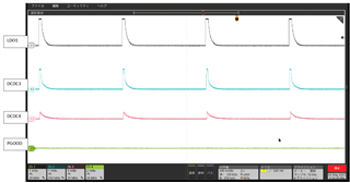

The output of DCDC4 drops at the timing of the red line in the attached file, and I confirmed that it does not start normally and seems to repeat the startup sequence.
The output starts to drop about 2.5 ms after DCDC4 output is ON.
In the situation, after 5 ms of DCDC4 rising up, the internal PG DCDC4 is judged as NG and the startup seems to fail.
Could you tell me all the conditions under which DCDC4 output goes OFF?

    It may also help to share waveform captures of DCDC4 and PGOOD, and DCDC4 and DCDC3 or 1.

    I send you a waveform capture as follows.
    If you notice anything, please comment.

    Thank you for the waveform capture. It appears DCDC4 is not able to reach the targeted output level 3.3 V.
    May I know the total capacitance on this rail , including that near the AM4378 processor?
    In the layout, are these capacitors (C21, C22, C23) placed close to the DCDC4 pin?
    And what is the expected current draw for this rail?
    It may be that the DCDC4 is starting up too slowly and causing a timeout error upon startup.
    If startup takes longer than 5ms, the rail will fail to turn on and reset the PMIC.
