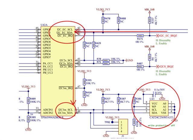

The customer mass produced this project.
The customer want to use the MCU (Connecting I2C_EC) to burn EEROM via I2C3m_I2C.
Whether it is available for TPS65994AD?
The process described in this app note should apply here also https://www.ti.com/lit/an/slvafl1/slvafl1.pdf?ts=1747407296575&ref_url=https%253A%252F%252Fwww.ti.com%252Fproduct%252FTPS25751
