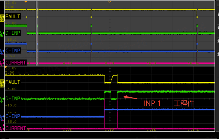

There is a Latch-off issue of SCP in CosMX MP project, please help to analyze.
  • For the MP samples of TPS1210-Q1 in same project board, the INP need to be pulled low twice to reset the latch.
  • For the Pre-production samples (Before RTM) of TPS1210-Q1, every time R&D pull the INP1 low can reset the latch.
