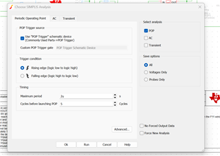

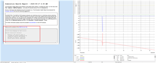

Whiile running POP Analysis i m getting below error with the simplis model avaiable on TI website of TPS546E25
Here is teh default POP setting
I tried to change the Maximum period but still same error.Can you please check and let me know what is issue?

  • Hi Rajat,
    Please follow below steps to run AC Analysis on TPS546E25 Simplis:
    • Run a Transient Analysis first

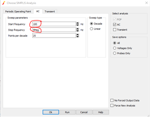

    • Then after running transient analysis successfully, uncheck "Transient" and check "POP" and "AC"
    • Change the maximum period to 100us
    • Run AC analysis

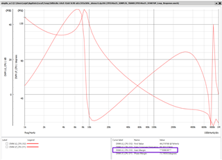

  • Hi Rajat,
    Regarding the Gain Margin value, this is because the Bode Plot is zoomed in on a specific frequency range, which does not happen to show the Gain Margin. If you zoom out on the frequency range, such as 100Hz to 5MHz, you should be able to see the Phase cross 0 deg and you can see the Gain Margin. Please see below image:
    Hope this helps

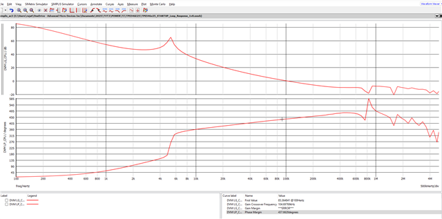

    AC Analysis -
    I can see my Phase margin is coming around 437 degrees. I am not sure with 437 degree what will be the regulation of my system.
    because for stable system the phase margin should be in between 40° and 70°.Above a phase margin of 70°, systems tend to be very stable but with extremely slow regulation.
