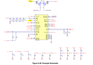

Hello, we have implemented your TPS25730 controller in our electronics, but before doing so, we were able to determine its operation by manipulating your TPS25730EVM test kit, configured to supply 20V and a minimum current between 0.5 and 1.5A. To do this, we toggled the switches as follows:
SW5 for ADCIN1: value 4
SW4 for ADCIN2: value 7
SW3 for ADCIN3: value 0
SW2 for ADCIN4: value 3
This allows us to verify proper operation, and therefore 20V.
This is with a 100W charger.
So we took inspiration for our electronics as shown on the supplied components, fixing the divider bridges by referencing your model, but it doesn't work, the measured output voltage fluctuates from 5V to 0V?....
Knowing that there are few external components to do this, what do you think the problem would be? Thank you for your support.
TPS25730 Geeps.pdf
  • In our schematic, we're not using I2C, but we've kept this option. For the moment, R43 and R44 are missing, and R101 and R102 are present.
  • Hi Laurent,
    Thanks for reaching out and sharing your schematic.
    From first glance, it is likely due to leaving the Fault in pin floating. You should bias it high (a weak pullup resistor to LDO3V3) to ensure it is in the "Maintain connection" state.

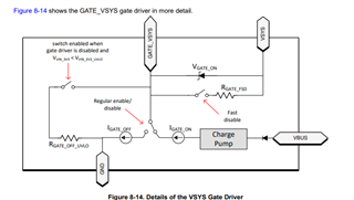

    In addition, you should have the VSYS pin connected to the PPHV node (the source of the system side fet of Q7) as this is the reference for the GATE_VSYS gate driver.

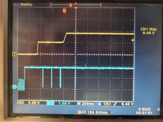

  • Hi Chris, and thanks for your reply.
    Yes, indeed, I noticed that the "FAULT IN" pin was floating, so I connected it as a 10K pull-up on LDO3V3, and my constants are indeed more stable now.
    However, I do have 20VDC on VBUS but only 9.1VDC on PPHV, even though I have corresponding fixed voltages measured on the ADCINx:
    ADCIN1 1.0426V
    ADCIN2 3.431V
    ADCIN3 0.0392V
    ADCIN4 0.0392V
    With an LDO3V3 output at 3.46V
    Indeed, VSYS should be at PPHV, and since I'm using the TPS25730EVM as inspiration, it's not present... so I didn't plan to address it, so I must...
    But if I understand correctly, VSYS is only a control for the reverse current and has no influence on the output voltage? This is why I don't understand why I have 9v instead of 20v in PPHV?
    Best regards
    Laurent Ifergane

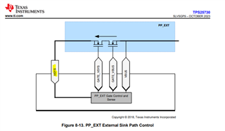

  • Hi Laurent,
    Because you are using the S (external power path) variant, the VSYS pin is used for biasing the gate driver GATE_VSYS pin. The TPS25730EVM uses the D variant (internal power path) so does not use the VSYS or GATE_VSYS pins.
    I'm not sure why your implementation is only accepting 9-V.

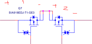

  • Hi Laurent,
    And to know that my electronics receive 20vdc which I see of course Vbus so before the MOsfet, so my charger is providing me with 20v ... but after the mosfet I only get 9v?
    If I understand correctly, with your board, you do see 20-V on VBUS, but you are dropping 13-V across the FETs?
    Is the 13-V drop shared between the two FETS or is it all on one FET?
    If it is primarily on the VSYS FET, it is likely because you do not have VSYS connected to the source of the FET. As mentioned above, VSYS is used as a reference for the charge pump gate for the GATE_VSYS gate driver. Without this properly connected, I'm not sure how the GATE_VSYS pin will behave.

  • Hello Chris
    Indeed, I needed to polarize the second MOSFET N via Vsys, which I connected to its source, and it worked.
    I'm getting my 20VDC output.
    Thank you for your help, which helped me move forward.
    Have a nice day.
