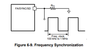

If using both R_fa resistor and external clock, is AC coupling cap or buffer needed? Or clock can be directly connected to SYNC pin which is already connected to R_fa?

    An AC coupling cap or buffer is optional. The datasheet shows a reference where you see the sync signal is directly connected to the pin.
    Please make sure to stay within the abs max limits and recommended frequency range.
