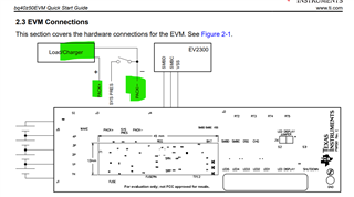

I have a BQ40Z50EVM-561 board and a EV2400 Controller. I have made the connections as per manual and connected a fully charged 3S battery. The charge has been done externally with a battery charger which shows full charge. When I reconnect this battery pack to my BMS setup I'd expect the FC flag to be set. But it still shows green. I have done the battery calliberation correctly as well by setting the measured cell voltage and pack voltage. I am not able to caliberate the bms as I am not able to complete a battery cycle as the software doesn't detect a full charge. Can you please help me with something that I am probably missing out?
PS - New to BMS circuits.
Thanks!
