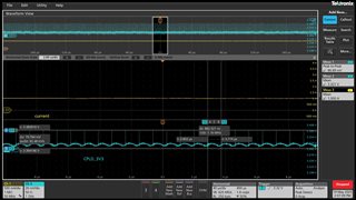

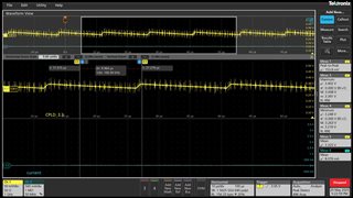

I design power supply system (3.3V form 12.0V)
The Vout is very noisy (Vp-p =  92mV - 116mV @ Iout=01A - 3A)
I read datasheet (8.4.1 Layout Guidelines) , But I can't find the problem.
The feedback line is routed from the load terminal through a ground guard.
What could be the cause of this?
