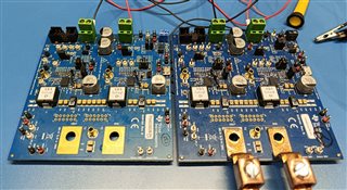

I am facing problems in 4 phase stacking. by using TPS546D24SEVM i was able to do 2 phase stacking now by using 2 TPS546D24SEVM i am trying for 4 phase stacking. i am not getting any communication error as i can see on BCX_CLK and BCX_DAT communication happening with followers. i will explain my setup it is as follows
1.I am using 2 TPS546D24SEVM in that for configuration i am using PMBUS programing not using Pin strapping method storing all values in NVM and doing pin detect override 0x0000.
2.STACK_CONFIG is 0x0003 and INTERLEAVE is 0x0040,0x0041,0x0042,0x0043 for master followed by 3 followers
3.for 2 EVM i am connecting BCX_CLK, BCX_DAT, SYNC, VSHARE and GROUND to each other
4.To make follower i am making sure that GOSNS pin is connected to BP1V5 by using 10k resistor in EVM that is R8_P1, R8_P2 and in 1st EVM R8_P2
5.i have made sure that VSEL, MSEL1, ADRSEL are all connected to AGND in follower.
6. for PGD/RST i have removed R26 which is connected to BP1V5. and connected it to PGND as per datasheet
7. VOSNS pin i have connected to PGND in SLAVES
from right side 1st is master and others are follower.

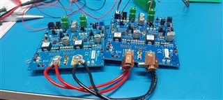

  • Hello sir
    I have checked my connection based on link which you shared i also connected output with   2,10sqmm wire for each output the resistance between 2 points between 2 EVM is almost 40 milli ohm
     also tried to connect output with   2,2.5 sqmm wire for each output. the resistance between 2 points between 2 EVM is almost 2 milli ohm
    now issue is voltage is stabilized but set voltage and measured voltage is different. measured voltage is higher than set voltage that is if i set 1v it is setting 1.2v in both scenario
    i tried to place it on top of each other but it is little difficult.
    i am getting error as
    VOUT error
    VOUT_UVF error
    VOUT_UVW error
    VOUT_OVW error
    VOUT_OVF error
    Thank you for your time.

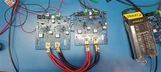

  • Hello sir
    I just made the stack placement as you guys suggested on top of each other. And after reducing wire length for output my problem got solved. Now 4 phase stacking is working fine with stable output current of 150 A i tested it. I just have 1 question not related to this post while testing i observe that tps device was responding to the address 0x00 also other than its assigned address. Is 0x00 is brocdasting address?
    Thank you for your time and help.
    Parth
