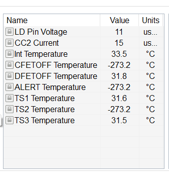

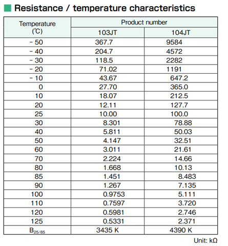

I am using 103JT NTC to calculate the temperature. Currently, my NTC has a resistance of around 10K in my ambient temperature. As per the NTC datasheet, the temperature has to be around 25 °C, but the Readings in BQ Studio are showing 31 °C. The Resistance vs Temperature look-up table is attached below.

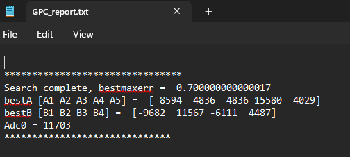

I have given this ZIP File to the TI GPC Tool to get the coefficients of the polynomial. Then the tool has generated the following values.

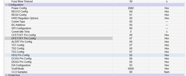

I am using DFETOFF, TS1, and TS3 as Temperature Sense pins. The Multi-Function Pin configuration in the picture attached below.

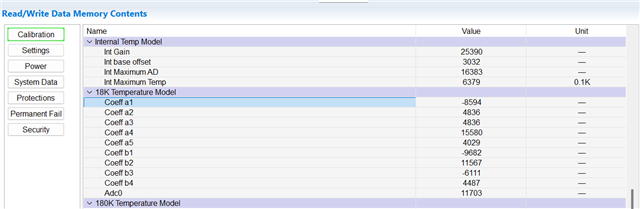

The 18K Temperature Model Co-Efficients screenshot is attached below.
Temperature Readings are attached below.
So, with the Co-Efficients given by the GPC Tool, I am getting a delta of around 6 °C, which is not acceptable in our application.
