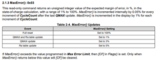

After several tests to obtain the configuration for my gauge (including successful learning and optimization cycles), I extracted the Golden Image directly from bqStudio; but before doing that, I reset the CycleCount to 0. This probably caused MaxError to suddenly jump to more than 100% (I tried the same operations with a learned configuration with MaxError = 1% and I see the exact same behavior). Can you confirm that manually modifying CycleCount can affect the MaxError parameter?
Eventually I tried to program another FuelGauge with the configuration with MaxError to over 100%, and tried to perform a few cycles: what I saw is that the MaxError dropped to 1% after two cycles, right after the end of charge. Can you please explain me how MaxError is calculated or how do I get a value close to 0%? The most important thing for me at the moment is to not get the parameter jumping suddenly to values close to 100%.

  • Hi Marco,
    The MaxError() does nothing in terms of gauging, it simply tells you the max possible error at a given moment. What are you using this register for?
    1) Yes and yes.
    2) Please view table 2-4 in the TRM.
    Diego
  • Hi Diego,
    I'm using this register to give a warning in case it exceeds 50%. What I understand from table 2-4 of the TRM is that MaxError() is incremented in the display by 1% for each increment of cycle count. Does it mean that if there aren't QMAX and Ra table updates, after 50 increments of CycleCount the value of MaxError() should be incremented by 50% too?
    Can you explain me better how can I create a golden image with CycleCount=0 without compromising MaxError?
    Thank you again,
    Marco
  • Hi Marco,
    Yes
    I would reset cycle count and increase cycle count threshold to its max value. Allow the gauge to take its ocv measurements and verify that max error has reset. Then go back into data memory set CC threshold back to the correct value and extract your golden image.
    Diego
