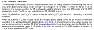

  • Hello Garett,
    Thank you for your response.
    I have attached a picture of the particular section.
    Notes on the schematic
    • BAT_TS is connected directly to the battery NTC. which is: 10K - 3435K
    According to section 8.3.5.4 in the datasheet (pasted below), it states that the IC will follow charging profile based on the feedback from the TS pin, doesn't that mean that the IC will use the TS value as an input to determine the charging profile?
    Thank you again
  • Hello Chamith,
    Thank you for your response. Unfortunately it appears there was an issue with attaching the picture of the TS portion of your schematic as I am unable view the image. Can you please help to resend the schematic image at your earliest convenience?
    Based on feedback from TS pin the BQ25628 will make adjustments to charging parameters shown in Figure 8-3. If TS is beyond TS_HOT or TS_COLD charge will be suspended. If TS is beyond TS_COOL charge current will be reduced by default and if TS is beyond TS_WARM threshold full charge voltage level (VREG) will be reduced.
